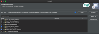

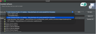

    To get going with Sitara MCU devices on CCS 12.7 please follow the steps outlined below:
    1. Start CCS 12.x
    2. Go to ‘Help’ -> ‘Install New Software…’
    3. In the “Work with” dropdown, select “Code Composer Studio v12 Updates”
    4. In the list that gets populated, scroll down and select the “Sitara MCU Device Support” and “Shared Device Support” entries, and then click ‘Next’ to install them.
    5. Wait for new packages to be installed, and click on ‘Restart Now’ when prompted.
    6. Once restarted, AM2x support should now be available.
