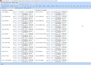

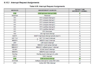

  • Hi Christopher,
    My sincere apologies for the delay in late response, we got couple of holidays in the last week and i also have so many other issues to gone through in this mean time.
    Actually, there will only two ESM interrupts in general.
    They are "esmHighInterrupt" and "esmLowInterrupt".
    But there will be ESM channels of 160.
    And each of these error channel can be configured to either High interrupt or low interrupt.
    If we configure one channel into the ESM high interrupt then it will be routed to the routine "esmHighInterrupt" and if we configured it into ESM low interrupt then it will be routed to the routine "esmLowInterrupt".
    From these routines we can call some notification functions and can handle the interrupts in those notification functions as below
