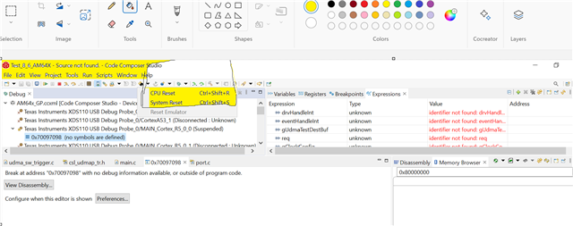

  • Hello Traveler,
    Actually, from the CCS there are two types of Resets, one is CPU Reset and another one System Reset.
    If you do CPU reset, the entire MSRAM memory holds the previous values.
    If you do the system reset, then the entire MSRAM memory will clear.
    So, please confirm which one you are using ?
    Anil.
  • Typically I am simply selecting "Debug" from the CCS run menu. My project is based off the am243x sdk "empty" project and I have not tried to trace what specific resets it is using.
    I have a target config with the settings I need for connecting to a live target, but I am not asking for help with this.
    To clarify my question:
    1. Are the spinlocks and mailbox for IPC reset by CCS during a Run->Debug? (I expect no.)
    2. My typical software test cycle is to improve the source code and then Run->Debug without power cycle. Power cycles are difficult in my hardware implementation so I would like to understand if the mailbox hardware can be reset by CCS during a debug cycle? If so, how? targetConfig setting? GEL script?
  • Hello Traveler,
    Sorry for the delayed reply. I was on training and other occasions.
    No, as I mentioned in the above, if you click the CPU reset, the IPC memory holds the previous values. If you do Warm Reset your SOC will start executing from RBL → SBL → Application. In this case, you need to load your application  from CCS.
    No, CCS can't reset the Mailbox hardware . You need to do Warm Reset the device and next load the same example .So, that your IPC memory can be reset other than this method ,we can't do anything .Warm Reset can be already done from CCS gel scripts .Please look at the below image .
    System Reset - > Warm Reset .

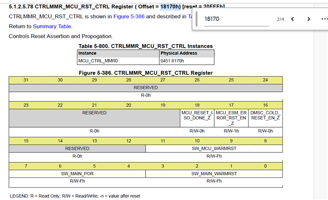

    Actually by controlling below Register from 0 to 3 bits also you can do the entire dvice Reset .So, that your IPC memory address also can be cleared .
