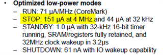

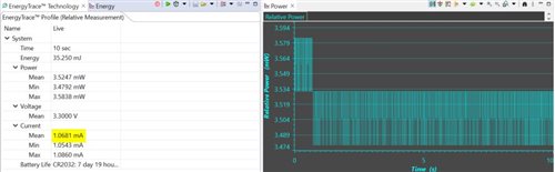

I'm checking the power consumption with low-power mode(STOP0) with EnergyTrace in CCS. I've removed most of jumpers in LaunchPad to isolate unintended power loss. However, I found the mean current was over 1mA. My expectation was about 200uA because STOP mode current is 151uA at 4MHz and Timer0 period for wake up source is 0.5sec. I'm using the example code "timx_timer_mode_periodic_stop" in SDK and revised Timer0 period.
Could you elaborate why the power consumption is so high than the specification in datasheet?
