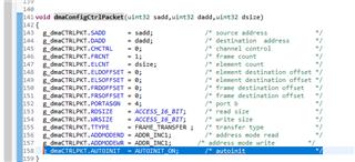

Hi, Does DMA support Roll over option for RAM to RAM transfer. If so, can you please provide the dma settings along with some example source code ?
  • Hi Bharath Kumar,
    Please refer below example.
    0243.DMA_memory_to_memory.zip
    In this example i am doing memory(RAM) to memory(RAM) transfer using DMA. Once the block of transfer completed then i am clearing the receive buffer and initiating the DMA transfer again.
    The main setting for rollover is that we should ON the Auto initialization.
    Thanks & regards,
    Jagadish.
