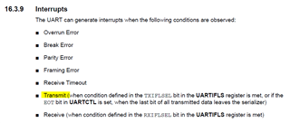

  • Thanks very much for your reply.  We use 9600 baud to communicate with our gauges in the field.  At 9600 baud it takes about 1 ms to transmit one character.  You don't see that as a big problem in most applications? Most transmissions would probably be 30 characters or less.  Once in a while (during transmission of profile data) there could be over 100 characters.
    In a previous version of this instrument I had a 1 ms periodic interrupt, and in the interrupt I would check to see if the transmit register was empty, and then turn off the transmitter, so I didn't have to have the main loop sitting and waiting.  I haven't figured out how to do that with this chip yet.
  • Hi Mark,
    You can do the same for TM4C129 to enable interrupt instead of polling.
    The uart_echo example in C:\ti\TivaWare_C_Series-2.2.0.295\examples\boards\ek-tm4c1294xl\uart_echo uses interrupt mode.
