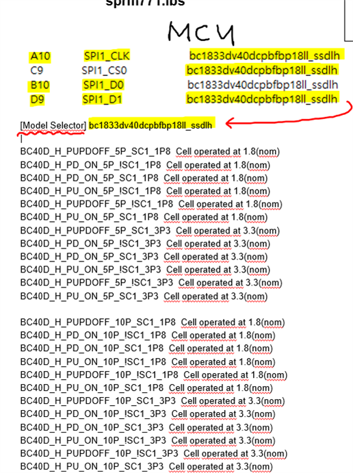

Could you please let me know what is '5P', '10P', '!SC1', 'SC1' in below model selection of IBIS file?
'PUPD' should be 'PULL TYPE' of Pin atribute and 'OFF'/'ON' should be 'BALL STATE', right?

Hi SI,
Please refer to the IBIS specification:
About 5P, 10P, SC1 etc, please read the description under the cell name. The highlight section is the comment or description:
[Model Selector] bc1833dv40dcpbfbp18ll_ssdlh
|SC1 IS A SLEW RATE CONTROL PIN
|5% SUPPLY VARIATION MODES WITH 1.8V NOM SUPPLY
BC40D_H_PUPDOFF_5P_SC1_1P8 Cell operated at 1.8(nom)
|BC40D_H_PUPDOFF_5P_SC1_1P8; BUFFER WITH WEAK PULUP/PULLDOWN OFF AT 5% SUPPLY
|VARIATION WITH SC1=1 MEANING SLOW MODE OF OPERATION
