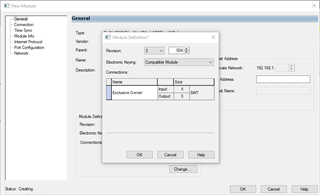

I have this EDS file for AM2434. The file comes with just one DATATYPE (SINT) when we import the EDS to the Rockwell Automation Studio 5000 software. I am working with field devices that work on DINT data type. and I need to be able to send DINT from my PLC (AB-L82ES) to the TI board. I tried modifying the EDS but that did not help. Need some help in understanding how can I change the TI EDS for DINT data type.
, thanks AB PLC FIXED DATA TYPE

    From your description I understood that you are trying to use the Generic Device Profile EthernetIP example. I checked with our EthernetIP Stack Expert and got some suggestions from his side regarding this.
    If you want to change the type for cyclic IO's from USINT to DINT, it's not enough to just change that in EDS file.
    You’d also need to change the application side of Generic Device example too.
    Our actual example supports several types already now on Class 70, Instance 1:
    • 64 USINT attributes (Attribute ID 0x300 - 0x33F)
    • 32 UINT attributes (Attribute ID 0x340 - 0x35F)
    • 16 UDINT attributes (Attribute ID 0x360 - 0x36F)
    • 8 ULINT attributes (Attribute ID 0x370 - 0x377)
    Actually, just first 5 USINT attributes (ID 0x300 - 0x304) are mapped by Assembly object as inputs and
    other 5 USINT attributes (ID 0x308 - 0x30C) are mapped as outputs by Assembly object.
    The Assembly mapping is done in EI_APP_GENERIC_DEVICE_cipSetup function in app_generic_device.c file.
    To change that you need to update the EI_APP_GENERIC_DEVICE_cipGenerateContent function in app_generic_device.c file and add after this line:

    This will add new 16 DINT attributes to position of previous 64 USINT attributes.
    Then class 70, instance 1 will look like this:
    • 16 DINT attributes (Attribute ID 0x300 - 0x30F)
    • 64 USINT attributes (Attribute ID 0x310 - 0x34F)
    • 32 UINT attributes (Attribute ID 0x350 - 0x36F)
    • 16 UDINT attributes (Attribute ID 0x370 - 0x37F)
    • 8 ULINT attributes (Attribute ID 0x380 - 0x387)
    With such a change you don’t need to change mapping inside Assembly object.
    The EDS file needs to be changed correspondingly - at least the "data type" and "data size in bytes" under each input and output parameter.
    Archit Dev
  • Hi Archit,
    We tried the suggestion you have given. It seems like the module is not communicating once we make the change. My suspicion is the EDS File change I made. I am attaching the file here for you to refer. Can you have a look and see if there is anything I have missed

  • Hi Archit,
    I tried the new EDS and it seems to have solved the part where I can change the Datatype on the PLC end. Thanks for that part! But the communication is still not up between the TI board and the PLC. I have captured the wireshark as you have asked. I saw the error code (0x54) for the IP that we changed the firmware for on the TI board. Attaching the file for your reference.

  • Hi Yash,
    On analyzing the Wireshark log, I can see that the additional status in the CIP Header is 0x0114.
    According to the Spec Vol1_3.36, this can be due to Vendor ID or Product Code mismatch.
    Can you please confirm what SDK version are you using?
    The EDS file we shared is from the Industrial Communications SDK version 9.2.
    Archit Dev
  • Hi Archit,
    We are using SDK 9.0 currently. Can you share SDK version 9.2 if the EDS is meant for to communicate with it.
