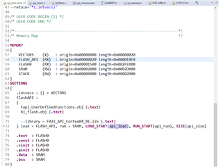

    Are you calling the "memcpy" function to copy the Flash API's to RAM?
    This is very important to move the flash API's into the RAM.
    Linker command file just provide you tags like "apiLoadStart" and "apiRunStart" etc. But actual data should be moved using memcpy function only. Once we copy the data into the RAM using the memcpy function, after that whenver we called the FAPI function the excution will takes from RAM instaed of flash.

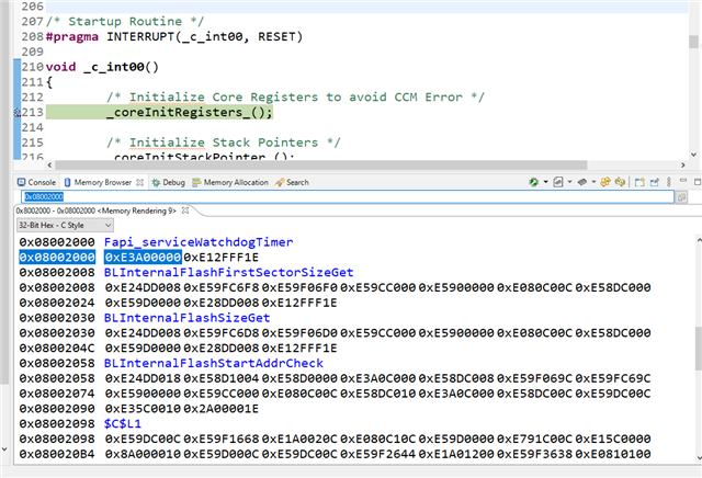

  • Thank you for your answer, it solved my problem. However, when I compile the bootloader source code, I can see that the FLASH_API value is assigned to RAM even in the void _c_int00() startup code. I wonder how this process is achieved?
  • Hi Mehmet,
    Apologies for the delay in my response i was stuck with other issues.
    Maybe it is just an old data. Actually, after first debugging you again reset and come to this function again, right?

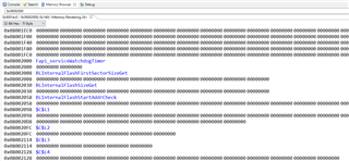

    If you did like that then the data shown in SRAM is the old one, i mean here we are not doing power on reset, here we just did software reset that is the reason why we were able to see the old data in the SRAM.
    Actually after "memoryInit" function the data in the RAM will get initialized to zeros like as shown below:
    And again, the flash routines will be copied to the RAM only after the "memcpy" functions only.
    Thanks & Regards,
    Jagadish.
