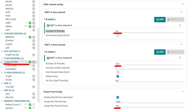

Hi all TI experts,
My current product uses the AM2431 as the main chip, and the SDK I am using is mcu_plus_sdk_am243x_09_01_00_41. I referred to the enet_layer2_cpsw sample program and modified it for our application.
Recently, I encountered an issue where the system functions normally with only a few Ethernet packets, but when a large volume of packets is present, errors occur. I discovered that the issue is related to the configuration settings in Enet (CPSW) -> ENET RX DMA channel > Packet Pool Config. The maximum setting for the Large Pool Packet Count is 192, but my system sends 807 packets within 8 ms, each packet being 1461 bytes. After transmission, there's an idle period of about 20 ms, allowing the MCU to process the packets. Observations using Wireshark show that the data rate is approximately 125 Mbps, and given the AM2431's capability to handle gigabit Ethernet, it should theoretically manage this workload. However, it appears that the volume of packets is too great, and there isn't enough DMA space to handle them all. I am looking for any suggestions on how to resolve this issue. Thank you!

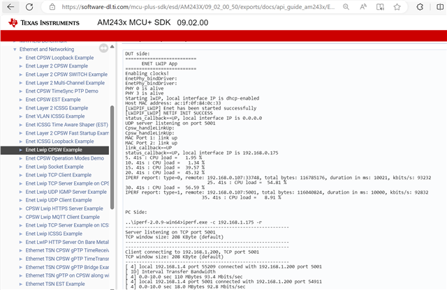

  • Hi ,
    Thanks for waiting patiently.
    As we can see you have described problem well.
    Can you help me step by step to follow to reproduce the issue faster?
    Meanwhile, can you please try the same steps on MCU-PLUS-SDK-AM243X Software development kit (SDK) | TI.com and confirm you are getting same results?
    Ashwani
  • Hi Ashwani,
    Sure, based on your description, I upgraded the SDK version to 9.2.0.50, but I am still encountering issues. What information do you need from me to reproduce the problem step-by-step?
    Here is some information that I think is necessary to provide:
    1. My AM2431 communicates with another Ethernet switch IC via RGMII, thus the External Phy Management is enabled.
    2. Each packet size is 1461 bytes, with an interval of 2-3ms between packet transmissions. This interval might decrease, depending on my settings. There can be up to 1000 consecutive packets received, followed by a rest period of 10-20ms, which allows the AM2431 to process the recently received packets.
    What other information do you require?
    Larry
    Better to have screenshots of the changes you have locally done?
    Ashwani
  • Hi Ashwani,
    This is AM243x-evm. correct?
     No, this is our product, where we use the AM2431 as our main chip. It is implemented on our custom board, not on a development kit.
    I can provide syscfg file content.

    enet_cpsw1.$name                           = "CONFIG_ENET_CPSW0";
    enet_cpsw1.customBoardEnable               = true;
    enet_cpsw1.mdioBusFreqHz                   = 200000;
    enet_cpsw1.ExternalPhyMgmtEnable           = true;
    enet_cpsw1.mdioMode                        = "MDIO_MODE_MANUAL";
    enet_cpsw1.macAddrConfig                   = "Manual Entry";
    enet_cpsw1.macAddrList                     = "E2:FF:0A:00:FF:FF,70:ff:76:1d:ec:e3";
    enet_cpsw1.hostportPadShortPacket          = false;
    enet_cpsw1.LargePoolPktCount               = 192;
    enet_cpsw1.txDmaChannel[0].$name           = "ENET_DMA_TX_CH0";
    enet_cpsw1.txDmaChannel[0].PacketsCount    = 2;
    enet_cpsw1.rxDmaChannel[0].$name           = "ENET_DMA_RX_CH0";
    enet_cpsw1.rxDmaChannel[0].sizeThreshEn    = 0x1;
    enet_cpsw1.rxDmaChannel[0].PacketsCount    = 190;

    To clarify, the development board I am using is the LP-AM243, so all my upcoming tests will use this board. I have modified the example code of enet_l2_cpsw for testing purposes, and I made changes in two areas.
    First, I modified the packet pool configuration in Enet(CPSW), changing the Large Pool Packet Count to 192, the Number Of Packets for the ENET RX DMA channel to 124, and the Number Of Packets for the ENET TX DMA channel to 64.

    "enet_lwip_cpsw" on the AM243-LP, and using the iperf command, the tested RX throughput was only around 10 Mbps.
    Are you referring below example ?
    Ashwani
  • Hi Ashwani,
    Yes.

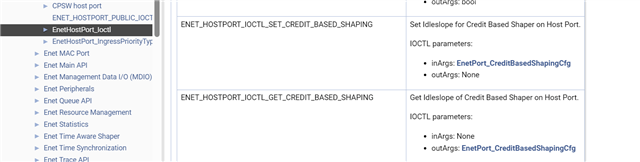

    Can you try shaping the traffic reaching to HOST by using below IOCTL?

    To correct, during my previous test of "enet_lwip_cpsw", my PC was connected to WiFi, which then connected to the switch, while the LP-AM243 was connected to the switch via RJ45. In this setup, the throughput I obtained through iperf was only 10Mbps. Last Friday, I corrected the test conditions by connecting both the PC and the LP-AM243 to the same switch via RJ45. Under these conditions, I achieved a throughput similar to the SDK documentation, around 50Mbps.
    Through this experiment, I have understood that the LP-AM243 can actually handle at least 50Mbps of data, and even up to 110Mbps under 100% CPU loading. However, why can "enet_lwip_cpsw" handle this data volume, but "enet_l2_cpsw" seems unable to handle around 50Mbps? Without lwIP, "enet_l2_cpsw" should be more efficient. What exactly is causing this difference?
    Larry
  • I achieved a throughput similar to the SDK documentation, around 50Mbps.
    Ashwani
        How can I using IOCTL?  can you give me some step by step example?
    Larry
  • I am using debug mode to test.
    You may try release mode for better results.
    As of now, we do not have a test code for this.
