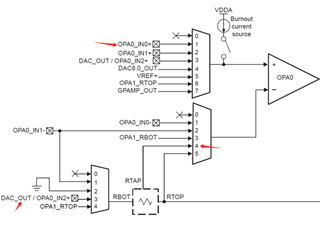

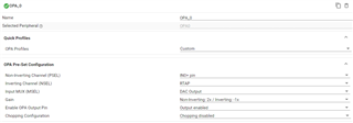

Hello, my OPA settings as blew:
use OPA0, bias and gain for signal.
this is my SysConfig
Here is the PinMux
Questions:
1.The bias is not effective, whatever the DAC output. The same with the <MSEL> use the <GND>
2.But the gain for signal is OK.
3.For PINMUX , why the pin select is PA26/30.    All pins some like a pair.  what means "/30"?
  • Hi Andy,
    How does you configure DAC output? You should enable DAC12 peripheral for this input.
    It means the pin number, if you check the PIN number of the PA26, it should be 30.
    B.R.
    Sal
  • 1.DAC output is enabled.
    I can change the output value to change the voltage. And the signal of PA15 is OK .

    Here is some comment of your issue:
    1. DAC output results could be measured by PA15;
    2. The output voltage is ((V_IN - V_DAC)*GAIN + V_DAC), and make sure the voltage is less than VDD.
    And if you have solved the problem already, please tell me and I'll close this thread. Thanks!
    Pengfei
