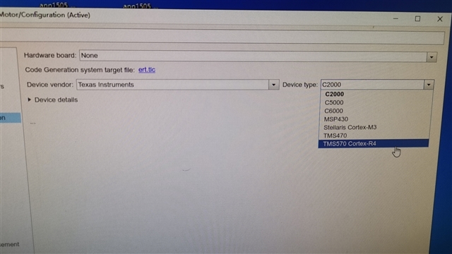

it seems that matlab do not have the corresponding MCU target of AM263P4,which target should be chosen to generate the code or which matlab version do you recommend?

Hi Joe,
We currently do not support AM263Px code generation in Matlab. We have a plan for basic feature support (parity with AM263x) around September 2024.

We need to meet customer's 1st July A sample date, is there any walk around method to generate the code in Matlab?

Hi Joe,
Right now it is not planned and neither in scope, neither do we have any workaround to support it before the GA release planned in September 2024 supporting AM263Px.
