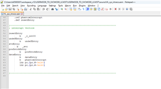

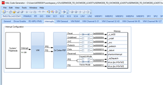

The problem I have is that I want to access the control registers of the mcu to start the time base clock for a pwm function I'm writing .
In Halcogen there's already a file generated to do that . But I need special access .I've attempted to write to access the privilege mode  which is below
In CCS it throws an error saying Illegal mnemonic specified.
Can anybody figure this out.

why does the compiler not recognize the assembly code ?
