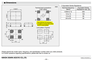

Ideally the shield of the crystal must me connected to the GND for better noise performance.
Please correct me if I am wrong.
Why these pins are not connected to GND?
Also, is there any problems if we connect the shield pins of the RJ45 connector and USB connectors together and connecting them to chassis GND?.
Looking for your reply.
      You can connect to GND but NC is also ok per vendor's recommendation. See below.

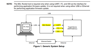

      You use the JTAG debug probe to load the 'bootloader'. Once the bootloader is running, it will configure your specified comms port (.e.g. UART) and is going download the firmware from that specified comms interface, not JTAG. For example, the bootloader is configured to download the firmware from a UART port. You need the BSL rocket connector so that the firmware download can happen through the UART interface or other interfaces like SPI and I2C. The XDS110 is only a JTAG debug probe that allows you to download firmware through the JTAG interface, not UART, SPI, I2C and others.
      I hope this diagram will clarify. https://www.ti.com/lit/pdf/slau746
    In our PCB we have MSP432E401Y and TM4C(XDS110) connected like in evaluation boards. So can we use UNIFLASH with "XDS Application UART" to load the bootloader?(even in bare microcontroller)
    Can JTAG in XDS110 load the bootloader code in the MSP432E401Y? if yes please tell how that can be done?

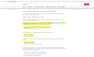

    To buy BSL-Rocket, is the below product link correct?
    https://www.mouser.in/ProductDetail/Olimex-Ltd/MSP430-BSL?qs=J7x7253A5u5ktaUHQ83VeQ%3D%3D
    If not, can you please provide the correct link?
  • Hi Monica,
      You can find additional information about BSL on the product page. https://www.ti.com/tool/MSPBSL
      Olimex-Ltd is our partner who builds BSL Rocket. You can purchase from them directly if you want from https://www.olimex.com/Products/MSP430/BSL/MSP430-BSL/. If you want to purchase from other vendors it is fine too.
      As you can see on the product there are other options as well like MSP-FET and MSP-GANG but BSL Rocket is the lowest cost option.
