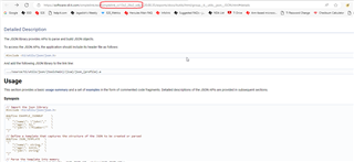

I was speaking about this ...
TI Utilities API: JSON Parser/Builder
Fabio
Hi Fabio,
If we verify this path carefully,
This SDK path is for CC13x2x7, CC26x2x7 controllers. And these controllers are not Hercules, and they are some wireless controllers provided by TI.
And i verified we don't have JASON library for Hercules controllers including TMS570LS3137.
