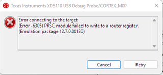

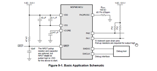

I have connected an MSPM0L1306 with a pinout board to the LaunchPad (LP-MSPM0L 1306). The internal MSPM0L1306 is disabled (Jumper to XDS110 opened)
GND, +3.3V, SWDIO, SWCLK, NRST are directly connected from XDS110 to pinout-Board.
The connection test in CCStudio is successful (target config - Test Connection), but I always get the error when starting a debug session:
CORTEX_M0P: Error connecting to the target: (Error -6305) PRSC module failed to write to a router register. (Emulation package 12.7.0.00105)
What can I do to access the registers of the external MSPM0L1306?
