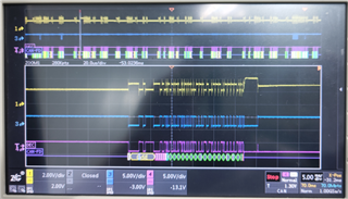

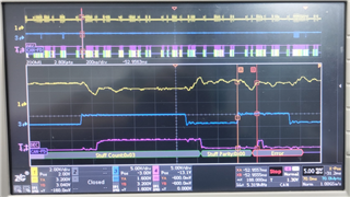

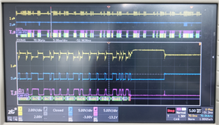

  • Hi, Ralph,
    Please check below signal captured during bus-off occurrence, and share your comment.
    Yellow: CAN_H
    Blue: TX
    Purple: RX

  • Hello Fan,
    After reviewing the information provided there a few points and follow up questions that arise:
    - There is a lot of overshoot and undershoot on CAN_H line (Assuming the same of the CAN_L line). Which is typical, but it seems a bit excessive.
    - Looks like there could also be some slight impedance mismatch on the CAN_TX line causing a bit of ringing.
    - Please verify that all nodes on the bus are using the same baud rate as this is the most common cause of repeated Transmit Errors.
    1) Is it be possible to see the termination circuits/HW implementation between device and transceiver and transceiver and bus?
    2) Is it possible to provide details on the scope/probe used to make these measurements? Probing these signals could likely in itself cause some interference/noise/skew in the system signals depending on the type and quality.
    3) Can an OBD reader be connected to the CAN harness and any warnings/errors reported?
    4)  We noticed that the transceiver in use was designed to work with a CAN Bus containing both CAN and CAN-FD transmissions. What are the system expectations for the AM263x device? (Baud Rate, CAN/CAN-FD, # of Nodes, Cable connection Length)
