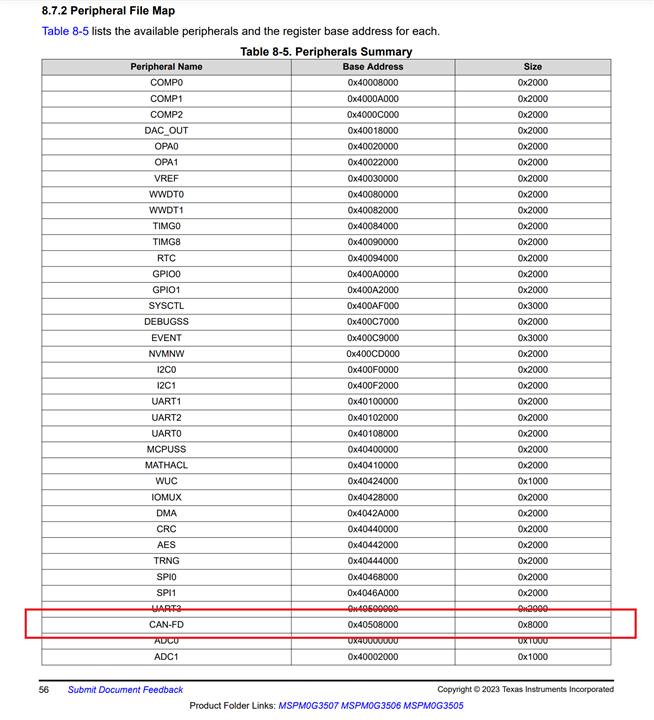

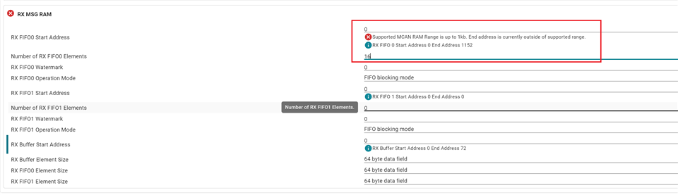

Would you please show us explicitly on the document the size of whole message RAM (for TX bufffer, RX buffer, RX FIFO0/1 etc) for MCAN?
In the datasheet, it seems to have up to 0x8000 bytes.
But from Sysconfig, it seems to have only 1KB, which is much different from 0x8000B above, so the user is very confused.
