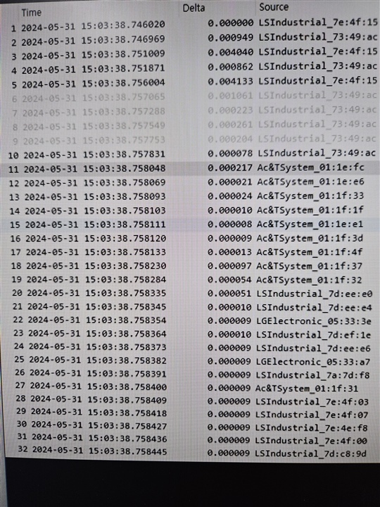

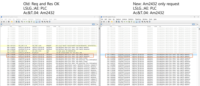

    In the following situation (AM243x CUT-THR mode), I captured packets between equipment nodes.
    A: Packet Generator (PLC)
    B: AM2432
    C: AM2432
    A - B - C
    Captured section
    - Between A and B
    - Between B and C
    When the amount of packets increases, at some point, the packets captured from A-B are not visible between B-C.
    I increased tx dma and rx dma from 8 -> 16 -> 24 in sysconfig and tested, but there was no significant change.
    (All links are 100 mbps)
    Can you tell me the limit of packets that AM243x can accept?
    If the amount of packets that can be processed is exceeded, are the packets dropped?
    I'm attaching a part of the test packet.
    I think you can measure the tx speed and total packet amount to some extent in delta time.

    Is the symptom reproduced only in CUT-TRH mode at 10mbps?
    I set my test PC's network adapter settings to 100Mbps instead of auto-negotiation, and the symptoms are the same.
    And even if you connect an AM2432 device (both PHY and OS are the same), communication works well at first in CUT-THR mode, but one port is blocked. (About 10 AM2432 devices are connected and sending and receiving data.) Devices that cause the symptom occur randomly.
    The time at which symptoms appear varies depending on the test, but usually occurs within 5 hours.
    As explained earlier, they are all the same symptoms.
    All port links are detected properly, but blocked ports do not communicate.
    This symptom does not appear in STORE-AND-FORWARD mode under the same conditions.

    I will send the saved packet.
    And here is the test environment:
    PLC (packet generator) - AM2432 - AM2432 - AM2432 - .... (minimum 25)
    1. The PLC already knows the information of the connected AM2432.
    2. IP/MAC is different for each AM2432.
    3. PLC sends a broadcast packet to the connected AM2432. (PLC Request)
    4. Immediately send a unicast request to each AM2432. (PLC Request)
    5. Each AM2432 responds to broadcast/unicast requests.
    6. Packet loss occurs while repeating the operation.
    7. It was confirmed that portQ0 Overflow increases as packet loss occurs.
    * Currently all switch modes for AM2432 are STOREANDFORWARD mode.
    I'd like to use CUT-THR mode, but I can't do it yet due to the issues mentioned earlier.

    There are two versions of the frame capture file I sent.
    One is when the patched PRU firmware is in the state,
    Another one is the PRU firmware before the patch is applied.
    The outcome of the communication (success or failure) is determined by the PRU firmware.
    The test environment is as follows.
    PLC - AM2432 (1) - AM2432 (2) - ....
    The existing PRU firmware transfers the frame from PLC -> (1) -> (2), but
    Patched PRU firmware will not be carried over.
    Also, communication is not possible, either because there is no response to the request frame from PLC -> (1) HOST, or because the frame does not go up.
    If you change only the PRU firmware in the same environment, the communication results will vary.
    I think that while modifying the port block, other parts were also modified.
    In other words, frame communication that previously worked normally does not work with the patched PRU firmware.
    Please check this part.

    It appears that there are issues with sending and receiving in the part where the ncm_mac_addr is used in the communication problem.
    Can you please clarify the below questions to help us investigate further:
    1. Is it only with this specific MAC address {0x00, 0xe0, 0x91, 0x02, 0x05, 0x99}, that the issue is seen?
    2. Is this issue with ncm_mac_addr occuring - with the patched_PRU_fimware only? Or was this observed with the older firmware?
    3. Without using the ncm_mac_addr mac address, how else did you perform the testing? In other words, how did you root-cause to your above statement?
    4. Kim had shared 2 pcap files before and after the PRU firmware patch, where we see that there are no VLAN-ID 2/3 tagged frames incoming to device with Host MAC 00:0e:91:02:05:99 (ncm_mac_addr). But the two FDB entry added in the above code snippet use vlanId =2/3 (ICSSG_FDB_IOCTL_ADD_ENTRY). Is this the intended behaviour?
    5. Please share with us the HOST_PORT and MAC_PORT statistics of the particular device during this issue.
    Thanks and Regards,
    Miriam
  • 1. Is it only with this specific MAC address {0x00, 0xe0, 0x91, 0x02, 0x05, 0x99}, that the issue is seen?
    A: Yes. i think so.
    A: It occured only patched PRU firmware.
    A: We additionally tested Ethernet/IP, which is one of the several applications, and confirmed that both the Old and New PRU firmware functioned correctly.
    However, we found that only the Old firmware works with the dedicated application that uses the ncm_mac_addr MAC address.
    A: I'm not sure which files Kim shared, but it can be inferred that packet information is reaching the host in the Old PRU since the request and response appear to be paired. However, in the New PRU, it seems that the Am243x only performs the request, indicating that packet information is not reaching the host. (See attached diagram)
    A: I will ask Kim about it.

    From the image shared above, we have understood that below is the topology:
    In working case:
    PLC (LSLG:....:ae)  <---------------->    AM243-1( AC&T:..:04) < ------Packet capture--------> AM243-2 (LGElectr:....:99)
    [ Sends Request to LGElectr ]          [Sends Response toLGElectr ]                                [Receives both NCM Request and Response]
    And in the case with the patched firmware, we had discussed internally on the potential reason for NCM response not being sent from AM243-1.
    We have some recent changes in our mainline with respect to this potential behaviour. And thus want to share a patch-2 with you to test in your test environment.
    Please expect the firmware patch-2 to be shared by tomorrow.
