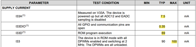

Part Number: UCD3138128A
I need to know the total supply current for UCD3138128APFCR.
Here, what current I've to consider?
Please help me with this.

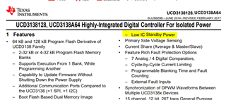

Hello Gokul,
It's hard to say how much total power the IC consumes. Are you asking about the standby power or what the absolute max power the UCD3138128A will consume (Ex. when everything is enabled and max processing power is used)?
On the first page, it highlights that the UCD3138128A is low standby power.
