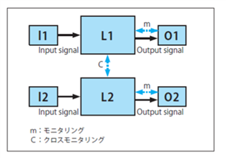

I got below question from my customer.
According to them, to meet ISO13849-1 Cat 3, cross monitoring between CPUs is needed.
In below figure,
m : monitoring
C : Cross monitoring
Does AM243x have such feature?
Thanks and regards,
