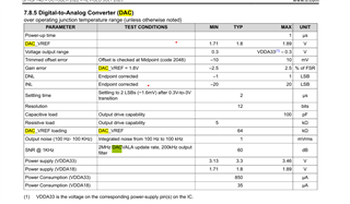

I want to generate a sine wave from the dac ( AM263x-LP ).
This is dac specification mentioned in datasheet.
what they meant by 200KHz output filter (whether it is limit of launchpad kit or IC) and how evaluation kit can be used to generate higher output frequencies  sine wave upto 1MHz?
  • Hey Tej_1441,
    The AM263x DAC module was integrated to support 100Hz to 100KHz.
    The use case for this DAC is to generate test signal for system level test/debug. Another potential use case is to generate control voltages for pass devices external to AM263x. As such, design efforts for the DAC were mainly focused on the DC linearity, gain error, and accuracy, with less emphasis on high frequency performance.
    I am syncing with the design owner here to provide additional feedback regarding the 200KHz output filter mentioned in the SNR row of the datasheet.

  • Hey Tej,
    1) This is just the parameter laid forward by our analog design team. I will make sure this information is clearly reflected in the TRM document.
    2) I am not aware of any single IC that will support this use case. My initial suggestion would be to use a dedicated DAC IC and utilize some communication protocol between the AM263x and the DAC to support your DAC requirements.
