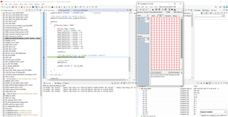

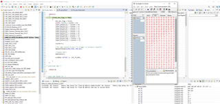

    I created one similar project to yours and verified with cache and without cache.
    With cache Enable:
    with cache disable:
    If we enable the cache, then i am always getting all zeros. I mean even though i am updating data that is not coming out to the SCI.

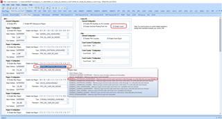

    The solutions for this issue are,
    1. One way is we can disable the cache, like as below.
    I already shared result for this in above pictures.

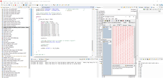

    2. The other way is that need to configure the corresponding memory into write through configuration as shown below.
    As you can see in this case i am enabling the cache but i am configuring RAM region as write-through, if we did configuration like this then the data written by CPU not only write through the cache and it will also be updated to the RAM immediately. So, if DMA access the RAM, then we can always get the updated data.
    Here is the test result for this:
    I am attaching my project for your reference and please go through it:
