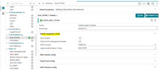

  • 1a)
     Regarding:
    "Change this to "Manual Entry" and provide your MAC address in the next prompt. Clean and rebuild your application and you will see the MAC address being assigned is as per your entry."
    Probably because I just updated by SDK, I do not see the "Manual Entry" option as seen here:

  • Hi Tollman,
    1a. This feature was recently added in 09.02 SDK release and won't be available in examples of previous releases.

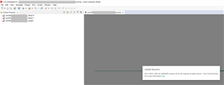

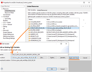

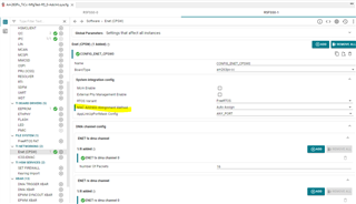

  • Hi Shaunak,
    I finally got free time to work on this.
    I created an empty project in another workspace and ported in the sysconfig configurations from by existing project. After doing so, I see “MAC Address Assignment Method”:
    However, When I replace the sysconfig file in my original workspace, and try to open it, I get an error:
    Upon seeing this I looked at the Linked Resources, in the original workspace, and noticed, although I had attempted to change the SDK path, it was set to my previous installed SDK. Again I tried to modify the pack, but it does not seem to work.
    1) How can I change the SDK path?
    2) Why does the sysconfig open in my new workspace, but the original one?  Is the SDK path the cause of the error?
    Tollman

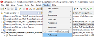

  • Hi Tollman,
    1. The process tried by you worked on my end. I tried changing from 09.02 example to 09.01 example and the reverse as well.
    2. If your changes are not very huge in syscfg, can you instead of replacing the syscfg, try to apply the changes manually in the 09.02 syscfg?
    3. This does seem to be a path related error. Another way you can try is go to CCS Window -> Preferences -> Code Composer Studio -> Products and from there remove the 09.01 SDK and add the path for 09.02 SDK.

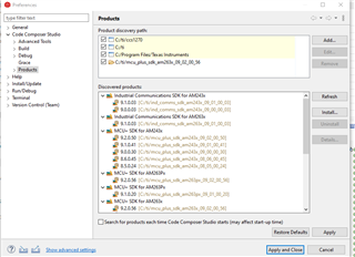

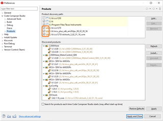

  • Hi Shaunak,
    2.
    Regarding:
    "If your changes are not very huge in syscfg, can you instead of replacing the syscfg, try to apply the changes manually in the 09.02 syscfg?"
    I did this by starting with an empty project. However, because of what is below (item 3.) I think I may have mistakenly still using the older version of sysconfig.
    3.
    When I upgrade my SDK, and CCS a few weeks ago I did not understand that I needed to update the settings in preferences.
    I tried to do so now, but I may not be modifying the setting correctly.
    I noticed when opening my latest sysconfig file in a different workspace this error:
    3a.
    I add the paths to the updated tools, but for some reason the icons are different from the ones in the original installation as seen here:
    Also, I cannot remove the original CCS version in this screen.
    Why?
    Tollman

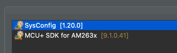

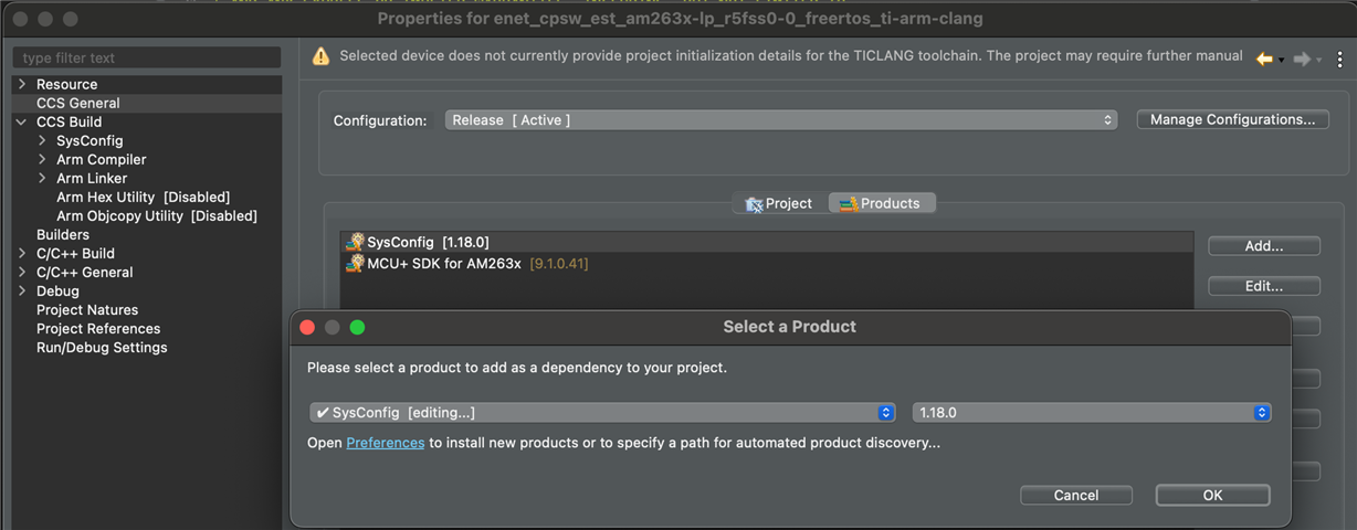

  • Tollman,
    The products section in the preferences dialog is used to help CCS find items like SDKs and SysConfig so that they are available for use.
    Which ones it actually uses are controlled at the project level.  i.e. each project will specify which version of an SDK, compiler or SysConfig to use.
    In your screen capture it looks like CCS knows where SysConfig 1.20 is ok.  However I bet the project is set to use an older version.
    Go to your project properties.
    Select "CCS General" in the tree on the left.
    Click on "Products" on the right hand side
    This will show which products and versions your project is configured to use.
    Select SysConfig and click the edit button on the right and a dialog will open that allows you to change this to 1.20
    After doing that it should show 1.20 as selected
    John
  • After modifying my CCS project "Products" to use the updated versions of the tools, I now see the Ethernet  “MAC Address Assignment Method” setting.
    Thanks for helping me resolve this!
