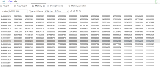

Want to store something in the flash. How to identify the location where to store?
This is the memory allocation. Is it fine if I store my data at location 0x3000. I have checked it it is empty.
Is there any automated way to find where to store the data, rather than me physically looking at the address?
EDIT 1:
this is how I am writing to the flash:
void flash_write()
    // write the variables pass,ctp,cts,op1,op2 to respective flash locations
    DL_FlashCTL_unprotectSector( FLASHCTL, MAIN_BASE_ADDRESS, DL_FLASHCTL_REGION_SELECT_MAIN);/* Unprotect sector in main memory with ECC generated by hardware */
    gCmdStatus = DL_FlashCTL_eraseMemoryFromRAM( FLASHCTL, MAIN_BASE_ADDRESS, DL_FLASHCTL_COMMAND_SIZE_SECTOR);/* Erase sector in main memory */
    if (gCmdStatus == DL_FLASHCTL_COMMAND_STATUS_FAILED)
        /* If command was not successful, set error flag */
        gErrorType = ERROR_ERASE;
    if (gErrorType == NO_ERROR) //cts   0x3000
        /* 32-bit write to flash in main memory with ECC generated by hardware */
        DL_FlashCTL_unprotectSector(FLASHCTL, MAIN_BASE_ADDRESS, DL_FLASHCTL_REGION_SELECT_MAIN);
        gCmdStatus = DL_FlashCTL_programMemoryFromRAM32WithECCGenerated(FLASHCTL, (0x3000), &ctp);
            gErrorType = ERROR_32BIT_W;
    if (gErrorType == NO_ERROR) //ctp  0x3008
        /* 8-bit write to flash in main memory */
        gCmdStatus = DL_FlashCTL_programMemoryFromRAM8WithECCGenerated( FLASHCTL, 0x3008, &cts);
            gErrorType = ERROR_8BIT_W;
    if (gErrorType == NO_ERROR) //pass   0x3010
        * 16-bit write to flash in main memory with ECC generated by hardware.
        * The target program address must be a flash word address
        * (8-byte aligned), so we increase the address in increments of 8.
        gCmdStatus = DL_FlashCTL_programMemoryFromRAM16WithECCGenerated(FLASHCTL, (0x3010), &pass);
            gErrorType = ERROR_16BIT_W;
    if (gErrorType == NO_ERROR) //op1  0x3018
        gCmdStatus = DL_FlashCTL_programMemoryFromRAM8WithECCGenerated( FLASHCTL, 0x3018, &op1);
    if (gErrorType == NO_ERROR) //op2  0x3020
        gCmdStatus = DL_FlashCTL_programMemoryFromRAM8WithECCGenerated( FLASHCTL, 0x3020, &op2);
This is how I am reading from the flash:
void flash_remember()
    //from each flash location read the value and store it in the respective variables.
    //variables are pass,ctp,cts,op1,op2
    ptrA=(uint8_t*)0x3018;
    // op1 =*ptrA;
    op1_temp =*ptrA;
    ptrA=(uint8_t*)0x3020;
    // op2 =*ptrA;
    op2_temp =*ptrA;
    ptrA=(uint8_t*)0x3008;
    // cts =*ptrA;
    cts_temp =*ptrA;
    ptrB=(uint16_t*)0x3010;
    // pass =*ptrB;
    pass_temp =*ptrB;
    ptrC=(uint32_t*)0x3000;
    // ctp =*ptrC;
    ctp_temp =*ptrC;
