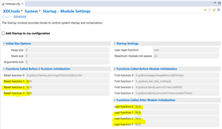

I am trying to have a startup function execute prior to C initialization.
I have updated release.cfg as below
var Startup = xdc.useModule('xdc.runtime.Startup');
Startup.resetFxn = "&appResetFxn";
Startup.firstFxns[Startup.firstFxns.length++] = "&appStartupFxn_First";
Startup.lastFxns[Startup.lastFxns.length++] = "&appStartupFxnLast";
My startup file contains the following entry
void appResetFxn(void)
Yet this function never seems to execute at startup.
Perhaps there is something else I need to configure?
Please advise.
Thanks In Advance.
