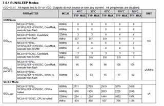

You will need to do that yourself. Very few people need *everything* enabled.
You need to comb through the datasheet and note the power requirements for each module. For the CPU core:
And for the ADC look for the supply current (and monitor current!)
It also depends on how the I/O's are configured and what load is on them.
Your best bet is to get the launchpad, set the thing up as you want, and use Energy trace to *measure* the current consumption.
The absolute max is 100 mA, but that is more of a total worst case scenario than anything you would actually run at.
