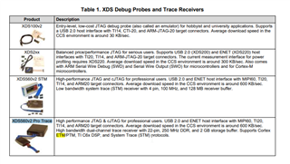

So what functions should I use to use the ETM function?
Same as ETM functions only.
Could you please tell me the source code for the example?

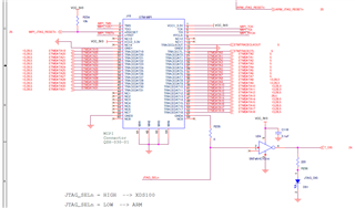

For this you don't need any code.
You just need external debugger which supports the tracing example XDS560.
Once you have this then you just need to connect this emulator to the ETM MIPI connector in the board:

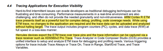

And now you don't need any application, you can just directly trace your application from CCS itself.
For more details please refer "4.4 Tracing Applications for Execution Visibility" section in below App notes.
*Hercules TMS570LC/RM57Lx Safety MCUs Development Insights Using Debug and Trace
