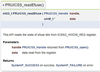

Non-EtherCAT Device
EtherCAT Sample application...
The "Non-EtherCAT Device" message is determined based on the value of the ICSSG_HWDIS_REG register.

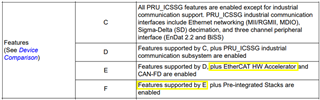

The MCU model we are using is AM2431BSDGHIALXR (Feature Code: D).
What possibilities could lead to the appearance of "Non-EtherCAT Device"?
