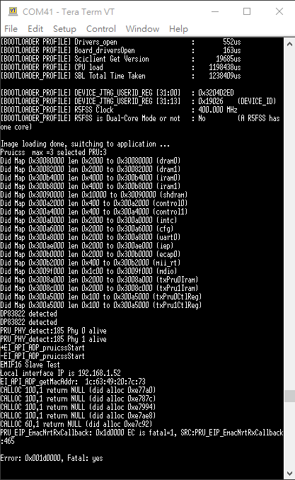

When we unplug Ethernet cable directly, the net LED become blink red. (connection timeout)
But we re-plug the Ethernet cable, the net LED is still blink red and we can't PING our device.
The communication is stop, and we can see error log "PRU_EIP_EmacNrtRxCallback".

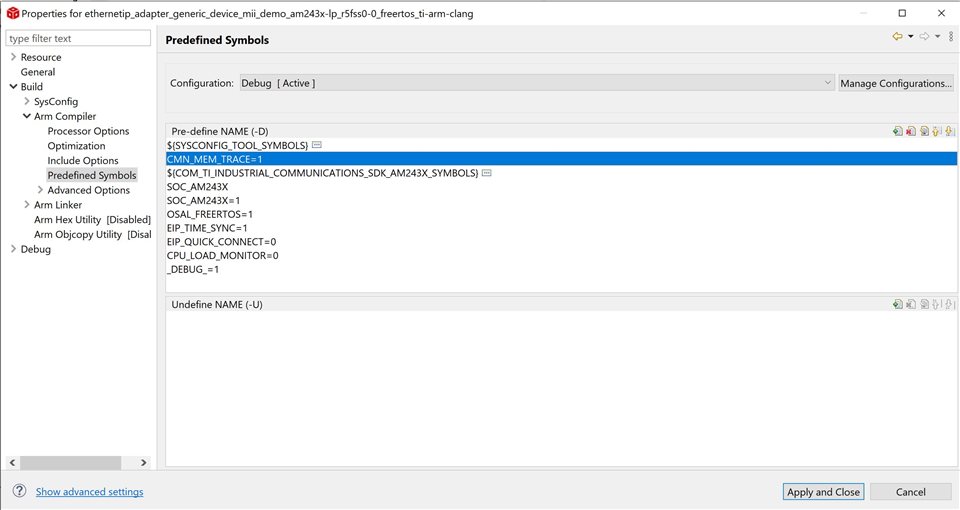

    5. Also, as one of the suggestions from our stack expert, can you try to activate the memory trace log?
    You can activate it by going to the Project Properties of your CCS project and add the following symbol under “Predefined Symbols”:
    CMN_MEM_TRACE=1 (see picture below)
    Afterwards the project needs to be rebuilt.
    By default when activated, the UART log starts to be generated in runtime and when a hard error occurs the actual full memory trace log is generated.
    In this case the runtime log is not needed because in time of initialization or communication, it can be updated too often.
    To switch off the runtime log you need to comment out the line with CMN_BOARD_init call in EI_APP_TASK_main function.
    With steps above the UART log with memory trace will be generated only when error occurs.
    To be able to check whether memory trace is working, you can put following line somewhere to the application side (normally I’m using it before main cycle in EI_APP_TASK_main):
    OSAL_error (__func__, __LINE__, OSAL_STACK_INIT_ERROR, true, 0);
    The project needs to be again rebuilt.
    When you are sure that memory trace is working, you need to remove the previously added OSAL_error line, rebuild the project and just start your tests.
    When the issue occurs again, you will have the memory trace in the UART log. Can you please share this UART log with us?

    The UART we show is one of successful case that we catch the log when problem occur.
    Could you explain what we get this error log?

  • Hi Joshua,
    Regarding the issue number 1:
    One important thing to note about the solved issue [OSS1-3213] (CALLOC failure) is that, the error you see right now in your use case, is with high probability a symptom of some other failure. For example, this bug was caused by a thread-unsafe call to CALLOC/MALLOC and as a result messing up the heap memory. And when the PRU_EIP_EmacNrtRxCallback was called later, it would fail.
    The reason I bring that up is that ANY thread-unsafe dynamic memory allocation might show the same symptom. So, if your code uses dynamic memory allocation or you are using some 3rd party libraries which might use heap memory, please make sure every call related to dynamic memory allocation is thread-safe.
    Pourya
  • Hi Pourya,
    Thank you for your reply.
    The user code which I add use static memory.
    Do you have any method to trace thread-unsafe call of CALLOC/MALLOC?
    [OSS1-3213] is occurred in Kunbus EtherNet/IP library.
    Maybe this library has another risk, but we can't get the source code.
    Joshua
  • Hi Joshua,
    you could use PC-Trace to see function calls during a debug session, you need to compile for debug configuration. The tool is under Tools->Hardware Trace Analyzer->PC Trace. After a breakpoint is hit or debug session is paused you can investigate the "Trace Viewer".
    the [OSS1-3213] is already resolved.
    The reason I made the remark about this issue, was to make you aware, where you could look out.
    Please share with us the memory trace log we asked a few days ago, and if you managed to have a "Trace View" result, it would also be very helpful to pin down the problem.
