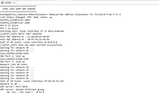

    Sharing my output below:
    Shaunak

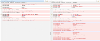

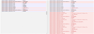

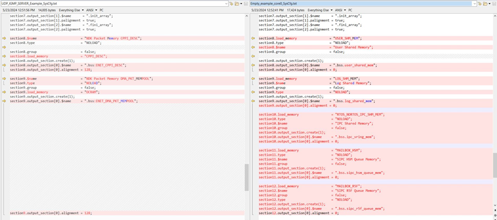

    I have found below potential differences when compared both SysCfg file of UDP_IGMP Server example and Empty project Core 0.
    Left side -> UDP_IGMP Server example SysCfg file.
    Right side -> Empty project Core 0 SysCfg file
    It shows I do not have memory allocation for NDK Packet Memory CPPI_DESC and NDK Packet Memory DMA_PKT_MEMPOOL
    section8.$name                       = "NDK Packet Memory CPPI_DESC";
    section8.type                        = "NOLOAD";
    section8.group                       = false;
    section8.load_memory                 = "CPPI_DESC";
    section8.output_section.create(1);
    section8.output_section[0].$name     = ".bss:ENET_CPPI_DESC";
    section8.output_section[0].alignment = 128;
    section9.$name                       = "NDK Packet Memory DMA_PKT_MEMPOOL";
    section9.type                        = "NOLOAD";
    section9.group                       = false;
    section9.load_memory                 = "OCRAM";
    section9.output_section.create(1);
    section9.output_section[0].$name     = ".bss:ENET_DMA_PKT_MEMPOOL";
    Do I need to map these to any specific memory regions?
    Please let me know if you find any other difference.

  • Hi Ajit,
    Yes, as expected, the issue seems to be with the CPDMA descriptor memory.
    One quick workaround you can try is, take the example.syscfg from the UDP IGMP Server standalone example and paste it in your empty project core-0 example.
    Then atleast we can be sure the UDP server can work. Over this then add any changed you need in core-0 project, else in core-1 project configure SPI.
    Shaunak
  • Thanks Shaunak!
    I have adjusted the memory allocation and it has resolved the issue.
