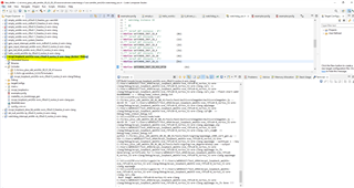

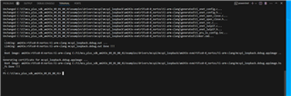

  • Hello Nirav,
    Can you please help me to resolve the issue at my side ?
    You can see the below images. I have compiled the same example and same version from CCS and made, But I did not face any problems.
    Did I miss anything ?
    Anil.
