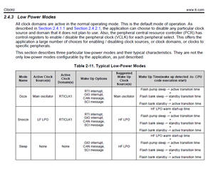

RM57L843: What to do if the junction temperature rises?
Part Number: RM57L843
The software detects that the junction temperature increased and it's about to violate the maximum temperature specification.
The software has no mechanism to turn the power off. The equipment is far from the office and it will take some hours to get someone there.
What actions the software can take to minimise the damage?
