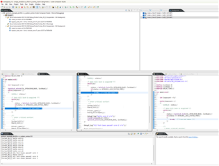

The problem is that when I put a breakpoint at the break statement, in each of the four cores I see multiple cores hitting that breakpoint.
My test sequence is:
  1. Reset all cores
  2. Reload the program to all cores
  3. Resume on all cores with the breakpoint enabled in each of them
 In most occasions, more than one breakpoints are hit, meaning that more than one cores have seemingly succeeded in reading a SPINLOCK_LOCK_STATUS_FREE status in the same Lock Register (INIT_ZERO_MUTEX which is defined as 0).
The only configuration that seems to perform more predictably is the one below, where there is an additional Spinlock_lock call in the beginning of this sequence to ensure that the spinlock is locked before any core get to the busy waiting stage. I have tested this multiple times and it always, so far, follows the predicted pattern of hitting the break statement breakpoint in the various cores in sequence and only after the previous core called Spinlock_unlock.

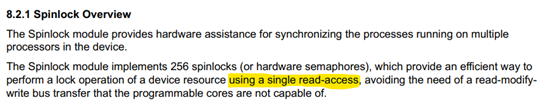

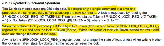

The design for the above mutual exclusion mechanism has been based on these statements in the TRM:
I interpreted this statement as:
Only a single resource (one of the cores in this particular case) can read the same lock register at any given time and then in any sequential read the register will return TAKEN (1).
However, what I observe indicates either of these scenarios:
  1. Two or more cores read the same lock register simultaneously and return a status of 0 (FREE), or
  2. A core is reading the lock register but the lock register is not set to one before another core gets access to it and therefore it is possible that two cores can read a status of FREE without writing 0 to the register.
Questions:
  1. Is my interpretation of how the Spinlock module works correct?
  2. Is there anything else that I might be missing about this module and/or my design?

  • Just an update from my side:
    Regarding the improved configuration, with the additional Spinlock_lock call before the main body, it behaves exactly as expected and consistently, i.e. each of the cores takes ownership of the "mutex" in sequence and executes the critical section.
    However, it only does so while debugging and hitting breakpoints at the break statement exiting the infinite busy waiting loop. If I disable the breakpoints and just let the target run through this code it ends up in a state where two of the cores have executed the critical section, unlocked the "mutex" and moved on and the third is seeing the "mutex" as still locked and is stuck waiting for it to be unlocked.

    I think I figured out what the difference is between this example project and the real project I am working on. System_init() and Board_init() are called before calling any Spinlock APIs. My assumption is that the Spinlock peripheral depends on the clock initialized by Dpl_init() which is the whole reason I want to use the spinlock/mutex anyway. Please see here for the related issue with Dpl_init().
    I tried to force the error in the example spinlock project by moving the
        System_init();
        Board_init();
        Drivers_open();
        Board_driversOpen();
    section in the critical section after acquiring the mutex. But it still seems to work fine. However, when trying to debug it, it hits breakpoints at the break statement in two cores at the same time.
    This seems so strange. Any insight?

  • Hello Manos,
    You are able to acquire spinlock in 2 cores when you added breakpoints, this might be because of that extra unlock at start of code.
    If you are using extra unlock then it might also happen that previous debug doesn't ended abruptly and spinlock is free before starting program in all cores.
    1. Now you loaded and started program.
    2. Core 2 acquired spinlock and hits breakpoint at line 61.
    3. Core 0 hits line 50 and unlocks spinlock (acquired by core2).
    4. Core 0 hits line 61.
    I don't think adding extra unlock at start is good choice due to this scenario.
    Thanks and Best Regards,
    Gunjan
  • Hi Gunjan,
    Yes, I came to the same conclusion yesterday. The additional unlock is the root cause of this issue.
    However, the scenario that the spinlock register does not get reset for a number of reasons is still possible, even if unlikely. Is there any other "out of the box" solution that also considers such cases?
    I guess the right tool for this would be a semaphore instead of a mutex because a mutex is much stricter in the required sequence of events, i.e. at first the mutex lock is free, then someone acquires it, then releases it so that someone else can acquire it. I think that in my use case, the assumption that we will always start with the spinlock free is probably 100% accurate as at that point in the application there are no interrupts enabled or anything that could disrupt this sequence.
    Manos
