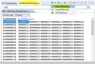

Hi Muneto-san,
In CCS under Memory Browser, you can save the memory content to file. Please see below. In Uniflash, you can do similar.
