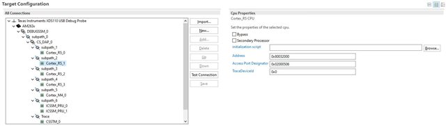

I am working on application that needs to configure UDP protocol on one core and SPI on another core and share data between each core. I am currently using empty project.
I have configured UDP into R5FSS0_0 and its working fine. Now I am trying to send data from core 0 to core 1. So, I have below doubts on this.
  1. Do I need to update Gel file for both cores? as shown below snapshot, by default R5FSS0_1 does not have any GEL file mapped. Also, do I need to modify GEL file at "..\..\emulation\gel\AM263x\AM263x.gel" for R5FSS0_1  core
2. How to check clock frequency of each core and change it? I think maximum frequency of each core is 400MHz.
3. How to debug both cores same time on AM2634 development board (TMDSCNCD263)?
Appreciate your support!
    No you don't need to modify GEL files for R5FSS0_1 core.
    You can check it for each core in example.syscfg->Clock.
    Select cores -> Group cores. Now you can reset, pause, resume etc. debugging for both cores together.
