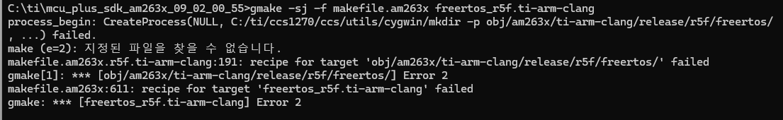

Part Number: AM2634
hi
My situation is the same as the link.
What's the solution?
Can you show me what's going to be built?
Part Number: AM2634
hi

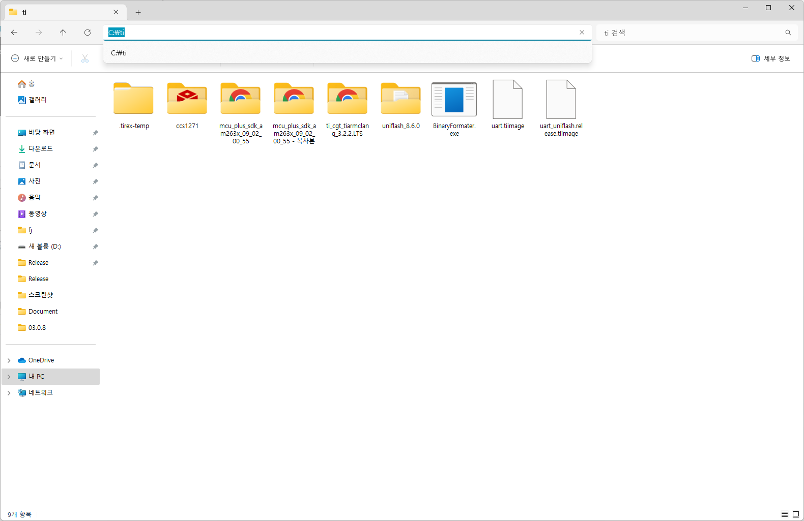

I made a ccs1270 folder and fixed it by copying it to ccs1270 what's inside the ccs1271 folder.
