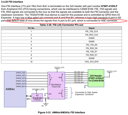

    2) Are you testing on a custom board or in one of our boards? if one or ours which one? LP? EVM?
       2.1) How is your setup? Can you trace (scope) FSI TX from sender/lead? If so, is this signal received OK on the other drive/node?
       2.2) Do you have other known-working FSI drives to test your new drives?

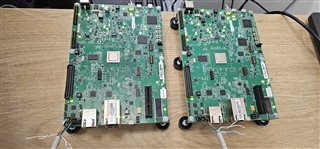

  • Hi
    1. yes, the loopback examples are running fine on each board.
    2.im testing on 2 EVM's
    i can share a part of the modules where i try to make a handshake sequence.
    im not getting any response from the node and when measuring with scope i dont see any signal from TX0_CLK or TX0_D0
    attached the code for the lead module and the node module

  • Sahar, also if you can send me a picture of your setup (both drives connected) it would be helpful
    thank you,
    Paula
  • Hi
    I saw the FSI documentation already,thanks.
    heres a picture of my setup:
    /resized-image/__size/320x240/__key/communityserver-discussions-components-files/908/20240602_5F00_110129.jpg
    The FSI wire is connecting these signals:
    TX0_CLK -> RX0_CLK
    TX0_D0 -> RX_D0
    But even with one EVM, im running a program to send data in a loop. and when measuring with a scope, im not seeing any signal from the FSI connector pins.
  • Hi Sahar, let me try to understand. You already tried a loopback with one board and it is not working? If so,
    Friday, I tried that on a AM243x Launch Pad and it worked for me. What I did was:
    - I kept everything from the example the same and just commenting out the loopback enable line
        /* Enable loopback */
        //status = FSI_enableRxInternalLoopback(rxBaseAddr);
        //DebugP_assert(status == SystemP_SUCCESS);
    - Then connecting the pins in loopback externally. For my test, for quick availability, I used an AM243x LP, so those pins are in J16 header on the board
    TX0_CLK -> RX0_CLK
    TX0_D0 -> RX_D0
    TX0_D1 -> RX-D1 (Probably not needed)
    On AM243x EVM I see there is a MUX which can select those pins between HSE and board's J5 header. Please check you are using correct mux settings for your test
    AM64x / AM243x Evaluation Module User's Guide (Rev. A)
    Let me know if loopback test with one board works for you, if so, then we can try between two devices
    thank you,
    Paula
  • Thanks for checking.
    Yes, the internal loopback test works for me, but not the external test.
    Regarding the MUX, that looks like a good lead. Can you tell me how to alternate the MUX state?
    And where can I see which pins in the HSE are connected to the MUX?
    Thank you.

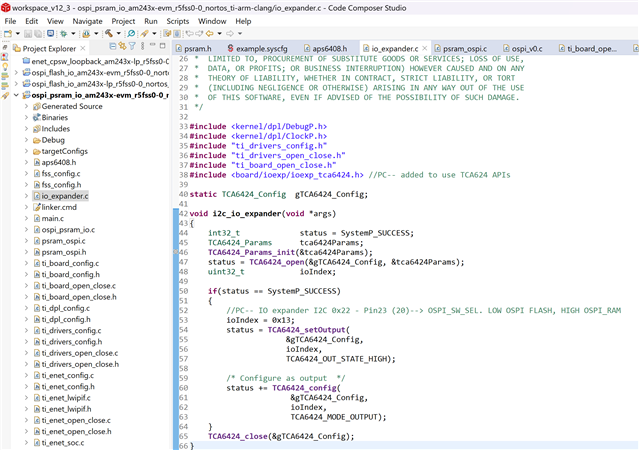

  • Hi Sahar, for configuring I2C to change IO expansion pin, please search for examples in which we use TCA6424 to have an idea. Below, is an snapshot example I am using for somthing else, just for your reference.
    There is a good FAQ: (+) [FAQ] PROCESSOR-SDK-AM64X: How to program TCA6424A using SoC_I2C1 - Processors forum - Processors - TI E2E support forums
    One small tip is to select the correct ioindex number. In my case I need to change Pin23 (20), so it really is ioindex =19
    thank you,
    Paula

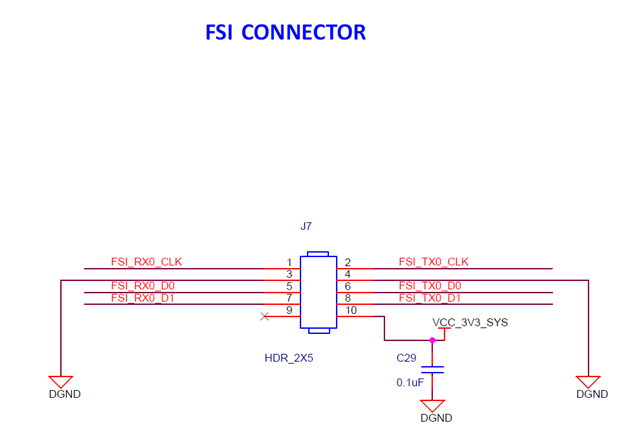

    Now im realy starting to see signals from the FSI connector. but for some reason im only seeing the RX related signals (pins 2 and 6).
    Can you please provide me a Schema of the EVM to make sure i configured the right pin?
  • Hi Sahar, you can download schematics from EVM page
    TMDS243EVM Evaluation board | TI.com
    File: PROC101C(005)_SCH.pdf
    Current package is for RevC
    Thank you,
    Paula

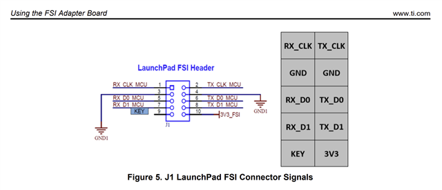

  • Hi Sahar, I believe you are using FSI connector (J7). If so, the pins you need to loopback (assuming you have a REV C - PROC101C(005) board: are:
    1 (FSI_RX0_CLk) -> 2 (FSI_TX0_CLK)
    5 (FSI_RX0_D0) -> 6 (FSI_TX0_D0)
    Please let me know if FSI loopback, with external pins, for one board, is currently working for you.
    thank you,
    Paula
  • Hi Sahar, with below code I was able to run external FSI loopback on an AM243x EVM using FSI (J6) header
     *  Copyright (C) 2021 Texas Instruments Incorporated
     *  Redistribution and use in source and binary forms, with or without
     *  modification, are permitted provided that the following conditions

    static TCA6424_Config  gTCA6424_Config;
    //PC-- added
    void i2c_io_expander(void *args)
        int32_t             status = SystemP_SUCCESS;
        TCA6424_Params      tca6424Params;
        TCA6424_Params_init(&tca6424Params);
        status = TCA6424_open(&gTCA6424_Config, &tca6424Params);
        uint32_t            ioIndex;
        if(status == SystemP_SUCCESS)
            //PC-- IO expander I2C 0x22 - Pin8 (P07)--> FSI_FET_SEL. LOW -> HSE connector, HIGH EVM J7 header (C2000 connection)
            ioIndex = 7;
            status = TCA6424_setOutput(
                         &gTCA6424_Config,
                         ioIndex,
                         TCA6424_OUT_STATE_HIGH);
            /* Configure as output  */
            status += TCA6424_config(
                          &gTCA6424_Config,
                          ioIndex,
                          TCA6424_MODE_OUTPUT);
        TCA6424_close(&gTCA6424_Config);

  • Forgot to mention, please also add I2C module in your project's example.syscfg
    thank you
    Paula

  • Already tried. it didnt work but i keep on trying.
    Will let you know if i will have any progress
    Sahar
  • Hi Paula,
    I made some progress today and managed to pass the test of 100 loops between two EVMs, but with a few changes.
    The most significant change is that I was able to do it only at a TXCLK rate of 1 MHz (maybe that value can be optimized, but I didn't check).
    At a rate of 10 MHz, I was able to pass some packets, but not all of them.
    I am trying to build a mechanism to request to resend data when a packet arrives with an error, and maybe then I would be able to work at higher frequencies.
    Attached is the code with the changes.
    //PC-- added
        uint32_t            ioIndex;
            ioIndex = 7;
                         &gTCA6424_Config,
                         ioIndex,
                          &gTCA6424_Config,
                          ioIndex,
    //PC-- added
        uint32_t            ioIndex;
            ioIndex = 7;
                         &gTCA6424_Config,
                         ioIndex,
                          &gTCA6424_Config,
                          ioIndex,

        /* Configure the IO Expander to connect FSI to J7 EVM header */
        i2c_io_expander(NULL);

  • Hi Sahar, I think I found the mistake in my setup. Please also check yours. I was missing connecting GND between both boards (J7.3 and J7.4 on AM243x EVM). After that, FSI loopback demo with 2 devices at 50MHz works OK.
    I also tried 2 FSI devices + FSI daughter cards TMDSFSIADAPEVM Daughter card | TI.com, which is the recommendation, and loopback demo also works great.
    FSI Adapter Board User’s Guide (ti.com)
    In case you want to tried connection between AM243x EVM and daughter card's FSI connector (J1), correspondence between pin numbers are one to one:
    AM64x EVM
    Header:Pin
    Pin Function
    FSI Adapter Board
    Header:Pin
    Pin Function
    Notes
    J7:P10
    VCC_3V3_SYS
    J1:P10
    3V3
    female-to-female jumper wire
    J7:P3
    DGND
    J1:P3
    GND
    J7:P1
    FSI_RX0_CLK
    J1:P1
    RX_CLK
    J7:P5
    FSI_RX0_D0
    J1:P5
    RX_D0
    J7:P2
    FSI_TX0_CLK
    J1:P2
    TX_CLK
    J7:P6
    FSI_TX0_D0
    J1:P6
    TX_D0
    Connecting this FSI daughter's card to an AM243x LP is even easier as you can just plug in on top of a LP. But you can also use jumper cables
    AM243xLP
    Header:Pin
    Pin Function
    FSI Adapter Board
    Header:Pin
    Pin Function
    Notes
    J16:P10
    VCC_3V3_SYS
    J1:P10
    3V3
    J16:P3
    DGND
    J1:P3
    GND
    J16:P1
    FSI_RX0_CLK
    J1:P1
    TX_CLK
    J16:P5
    FSI_RX0_D0
    J1:P5
    TX_D0
    J16:P2
    FSI_TX0_CLK
    J1:P2
    RX_CLK
    J16:P6
    FSI_TX0_D0
    J1:P6
    RX_D0
    A quick note, between daughter's cards there is LVDS TX (RJ45) from one board goes to LVDS RX to the other board (RJ45)
    Please let me know if this resolves the issue.
