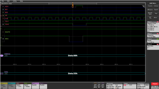

Strongly based on the SDK's GPMC sample code, the GPMC module was set for synchronous communication (at 21.33MHz -192MHz/9-) looking for the following behavior on a write cycle (RE-Rising edge, FE-Falling edge):
RE0: BE1 low, Address/Data set, ADV low, WE low
FE0: CS0 low
RE1:ADV high
FE1: -
RE2: WAIT0 sampling (to be repeated if active until inactive)
FE2: CSn0 high
However, the WAIT0 signal seems to be ignored -for both low and high levels-, as seen in the scope (attached): waveform is the same irrespective of the WAIT0 state. Also attached is a memory dump of the GPMC registers settings.
Should another setting be changed to achieve the sampling of WAIT0 signal?
Javier

  • Hi Rijohn,
    It is a legacy FPGA that I am attempting to access. I am attaching the read/write cycles as commanded by the AM2631: please notice the WAIT check on the third rising edge.
    Javier

  • Hi Javier,
    GPMC0_WAIT Signal is an input signal to the GPMC controller. GPMC access time can be dynamically controlled using an external GPMC_WAIT pin when the external device access time is not deterministic and cannot be defined and controlled using only the GPMC internal RDACCESSTIME, WRACCESSTIME, and PAGEBURSTACCESSTIME wait-state generator.
    So, basically this signal should be generated from memory device / FPGA. And hence irrespective of the wait configuration of the GPMC, we should be able see the wait signal toggle (as it an external signal from FPGA indicating if busy/not).
    Can you please check if there are any more pin configuration needed to be done from FPGA side?
    Also, Please refer to AM263x datasheet section 7.11.5.7 and ensure GPMC timing parameters are configured as per your use case.
