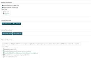

    I have done some tests using Uniflash 8.7 and customer's hex file. I can download the file successfully twice. And I recommend you choose to erase MAIN and NONMAIN at the secondary time, not choose to erase MAIN memory only. Because the hex file includes the data of NONMAIN, if you only choose to erase the MAIN flash and there is NONMAIN code in your hex file which will be download using uniflash, maybe some error will occur.

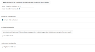

    The setting of uniflash I used:
    And the download results I got:
    Janz Bai

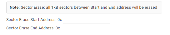

    Maybe my erase method is wrong.
    Can you tell me how to erase on Uniflash?
    I am currently using sector erase.
    Maybe I need to use entire flash bank erase instead?
    Steve
  • Hello YUXUAN,
    1). A Flash word is 64 bits (72 bits with ECC). A sector is 1 KB and a bank is up to 256 KB (Most devices implement a single flash bank (BANK0). And the BANK0 includes NONMAIN region, MAIN region and FACTORY region.
    2). If your code file just has MAIN region, you should use the "erase MAIN memory only"
    if your code file includes MAIN region and NONMAIN region, you should use the "erase MAIN and NONMAIN memory" or "erase MAIN and NONMIAN necessary sectors only" (recommend use this)
    if you download code file including MAIN and NONMAIN first time, and you want to download code file just including MAIN, you should choose the "erase the MAIN memory only" and confirm your code file just includes MAIN region.
    3), if you use sector erase, you should write the address you want to erase at there:
    4). I recommend you use the point 2) to prevent you from writing wrong address. And you should notice that if you want to erase NONMAIN region, you must confirm that your code file which you want to download must include NONMAIN.
