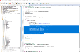

Observe a strange behavior of N2HET device on LAUNCHXL2-570LC43.
In pooling mode, at rate 5 ms, it captured correct period value after boot. Then after 2 to 5 min, period value doble, and it continue in this state till you reset controller. Always repeatable for input square from 100 - 4 kHz.
What can be a reason?

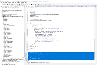

  • Hi Aleks,
    I verified your HET code and i didn't find any issues in it. It looks fine for me.
    So, i should need to test this one to find out what went wrong.
    And i would like to know the following things for testing:
    1. Here you enabled 4 pins (pin-11, pin-16, pin23 and pin31) right, for which pins you are facing issue? Did you test with all the pins?
    2. And also need your application code, how you are reading and processing the captured data. If i get this then want to create similar project and want to verify the behavior.
    Thanks & regards,
    Jagadish.
  • Hi Jagadish,
    1) 2 pins in use (16, 23) and 2 backup (11, 31). it doble values for 2 in use at the same time.

  • Hi Aleks,
    I am trying to create a similar project, however my suggestion would be just trying to create one sample project from your end. This would be helpful for me to solve the issue easily.
    Thanks & regards,
    Jagadish.

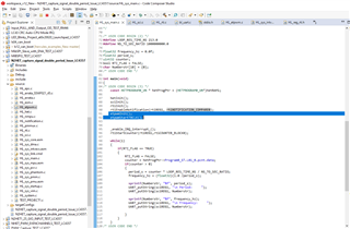

  • Hi Aleks,
    Based on your inputs i created one example project, and i didn't see any issues in the period and frequency measurements.
    First i want to explain what i am doing in my project:
    First i am generating a PWM signal using eTPWM module and i want to use this as input to our N2HET module. Here i am generating PWM signal with 1mS period.
    And i am creating RTI interrupt for every 1Sec, whenever i get this RTI interrupt then i want to print the capture period value to the SCI.
    So now i connected my generated PWM signal on D9 pin of the controller with the N2HET1[16] that is A4 controller.
    And i did the testing for 15mins and i got the same values, i never see period double issue any time in testing:
    I always got period ~1ms and frequency 1Khz.
    In your case i am suspecting maybe it is an input issue, i am attaching my project for your reference. Can you please test this project and see whether you are getting the same issue or not?
    N2HET_capture_signal_double_period_Issue_LC4357.zip
    Thanks & regards,
    Jagadish.
