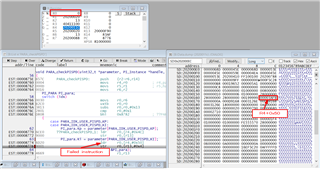

The issue was firstly found that here the variable PI_para.Ki  was not valued right.
We found, in picture 1, it's because the ldr did not read the value to R0, but if we set a breakpoint at line 0x8772 and step through it, it can load value to R0 as expected.

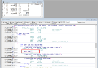

Besides, in picture 2, after we placed a nop before the ldr, it works.
picture 1:
picture 2:

    The value is read from an array, starting from address 0x2020011c, which had been initialized at the very beginning. And the routine here is to read a value from the array and write to Stack area.
    Not every ldr would be failed. In the picture 1, the ldr at 0x8770 works well.
