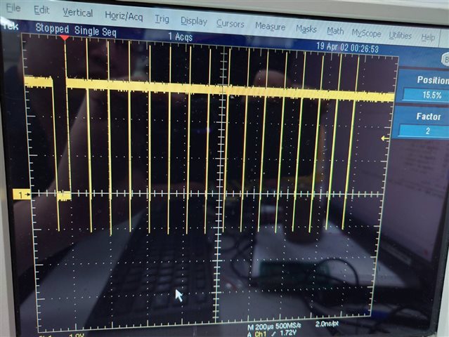

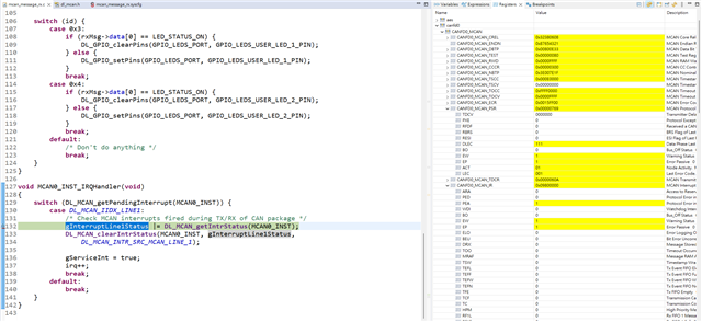

I have set two variables in the program to check if it enters the interrupt and if the program finishes. Everything seems to be working fine, but there is still no signal generated. What might be the issue? Neither of the examples produce a TX signal. The first time I flash and run the program (pressing PB21), I receive a strange error waveform. However, no matter how I test it afterward (pressing PB21), there is no activity on the TX pin. The oscilloscope shows the signal remains at a high level with no changes.
The image above shows the signal generated the first time I press (PB21) after flashing the code (the signal content does not match the transmitted data). However, no matter how I test it afterward, the TX pin does not produce any signal and remains at a high level.
