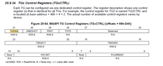

    In section 25.9.34 TGx Control Registers (TGxCTRL) of the TMS570LS31x/21x Technical Reference Manual, it says regarding TGENA:
    "TGx enable.
    If the correct event (TRIGEVTx) occurs at the selected source (TRIGSRCx), a group transfer is
    initiated if no higher-priority TG is in active-transfer mode or if one or more higher-priority TGs are
    in transfer-suspend mode.
    Disabling a TG while a transfer is ongoing will finish the ongoing word transfer but not the whole
    group transfer."
    So it looks like if the Slave asynchronously clears TGENA, we could still interrupt a transfer group.in the middle of transmission.-- causing all 1's to be sent to the Master for the remainder of the transfer group.
