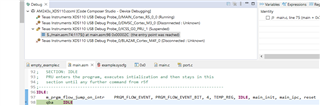

MCU-PLUS-SDK-AM243X: connect to R5F0-0 and PRU1, the firmware executes successfully the first time, using the same code, but fails the second time
Part Number: MCU-PLUS-SDK-AM243X
I am using R5F0-0 and PRU1 to transfer data from PRU to R5F, when I execute my test code, it works well the first time, but fails the second time, I don't know why this happen, please help me.
Here is part of my code in R5F:

Here are the steps in my development:
1. SOC initialization
1. OSPI boot mode, power off and then power on
2. launch selected configuration
3. connect to R5F0-0, reset CPU, load firmware
4. connect to PRU1, load firmware
5. run R5F0-0, and then it always in the below process, it seems that R5F is waiting PRU1 to send data, but PRU1 is always in IDLE process, that means PRUICSS_goToSection execute failed in the second time
I don't know why this happen, please help me, thanks.
