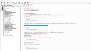

    My suggestion is that, you can find FEE example for RM48 in HALCoGen itself. You can access it by the following steps:
    First go to the "Help Topics" section in the HALCoGen
    Here in "Examples" section you can find the example called "example_TI_Fee_Write_Read"
    In this example you can find step by step procedure along with the code for FEE example.
    Just follow these steps.
