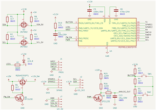

I have problem to run the code without debugger. With the debugger is all functional. The code
run on VQFN-32 package without the debugger. But with the package SOT-16 the code do not
run without the manual start over the SWD. The reset HW is same as on the launchpad (47k Ohms
pullup and 10 nF capacitor). I have no idea where can be the problem.Running the bootloader?
Can anybody help me with this?
