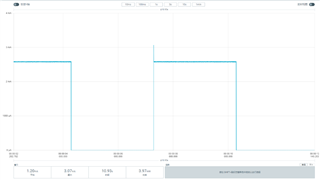

    Here is a very basic example of code which shows this excess current consumption by disabling the debug function on the SWDIO pins in the syscfg file.
    I'm measuring current on an LP-MSPM0L1306 board by inserting an ammeter between pins J101.5 and J101.6.
    The progam is loaded (not in debug) and jumper in SDWIO pins between the XDS110-ET debug probe and micro-controller are removed.
    The system toggles  between STANBYMODE0 (LED1 off) and RUN (LED1 on) each 3 seconds.
    When  SWDIO function is enable mesured  current toggles between 4µA and 6.47mA.
    When SWDIO function is disable, mesured  current toggles between 1.08mA and 6.72mA.
    Hope this helps you find what's wrong.
    Jean-Paul Lopes

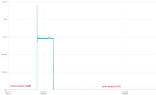

    I see the same phenomena whether SWD is enabled or disabled.
    I have just remove all the jumpers J101. Use power monitor to see the current.
    Here is the result:
    I think the odd result might lie in the test hardware environment.
    Zoey

    Yes I just re-compiled the code with and without the SDWIO feature enabled to compare the two mode.
    I have also  written a new test code from my side to check the current. Please check E2E_SWDdisable.zip
    B.R.
    Zoey
    I finally found what the problem is :
    To avoid excessive current consumption, I have to do a POR after programming.
    It appears that a lower reset level is performed after programming and some debug functions remain active.
    Thanks for your time helping me.
