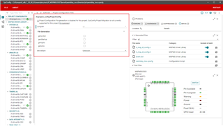

  • Why am I grayed out, I'm operating in IAR 9.5.0 IDE.
    Can you try with the latest SDK version 2.00.01.00 and Sysconfig version 1.20. Check if it can help.
    Cash Hao
  • Why is trying to use 2.00.01.00 still gray, which project are you based on. i am going to use freertos and ti-driver
    I am using the no-rtos project.
