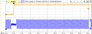

I am outputting the internal clock (set to 4MHz) and monitoring it with an oscilloscope, but
as shown in the figure below, the output waveform of the internal clock becomes strange when the GPIO output switches to High or Low. (The output voltage becomes low and the cycle is abnormal.)
The orange waveform is the GPIO output, and the blue waveform is the internal clock output.
Why does this happen?
Also, I am using the internal clock for timer operation, so will this have any effect?
Please check.

    I have tested from my side. As the MCU enter into GPIO interrupt not trigger timer-compare, everything goes well. Can you also have a try?
    And I want to make clear the orange waveform is which GPIO.
    Zoey
  • 「As the MCU enter into GPIO interrupt not trigger timer-compare, everything goes well.」
    What does the above mean? I'd like to know more about it.
    The orange waveform uses USER_LED_1 = Pin 27 for output.
    In addition, Pin 16 and Pin 17 are used as outputs,
    and if any of the outputs are inverted, the frequency output will be strange.
    Zoey is OOO for next two weeks.
    I will help Zoey test this issue.
    Helic
    I have reproduce this issue and try to find some method to solve it~
    It may caused by GPIO interrupt with SYSOSC set to 4MHz.

    Can you try to run this API when system init done?
    DL_SYSCTL_disableFastCPUEventHandling()
    This will disable SYSOSC switch from 4MHz to 32MHz when a interrupt happened.(For faster response to interrupts)
    I think this will help you a lot because I have test SYSOSC=32MHz, there is no CLOCK OUT issue.
    Helic
  • In the current program, does this mean that the frequency switches from 4MHz to 32MHz when an interrupt occurs?
    And then it goes back to 4MHz after the interrupt?
    Could this frequency switch be the cause of the problem?
    It should be back to 4MHz after finishing interrupt entering.
    When running interrupt hanlder, such as switch and GPIO toggle, CPU still running at 4MHz.
    Yes, this may be the reason.
